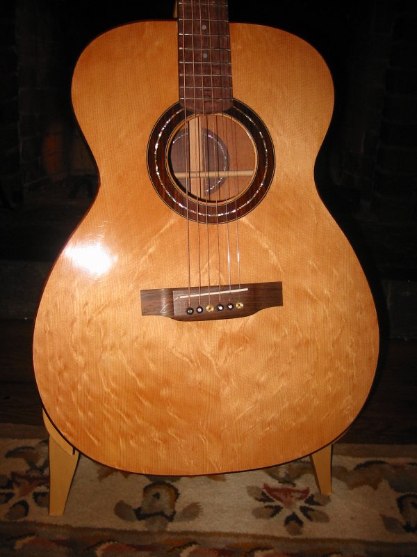

Here are a few shots of my latest. A Mahogany 000 with Bear Claw soundboard. Bindings are EI Rosewood as is rosette, bridge, fretboard and headstock veneer.
No completed yet. Fretboard and bridge not glued up yet as I usually bolt everything up and do the setup work and then disassemble to do finishing. The finish is Nitro with minimum coats and needs finish buffing.

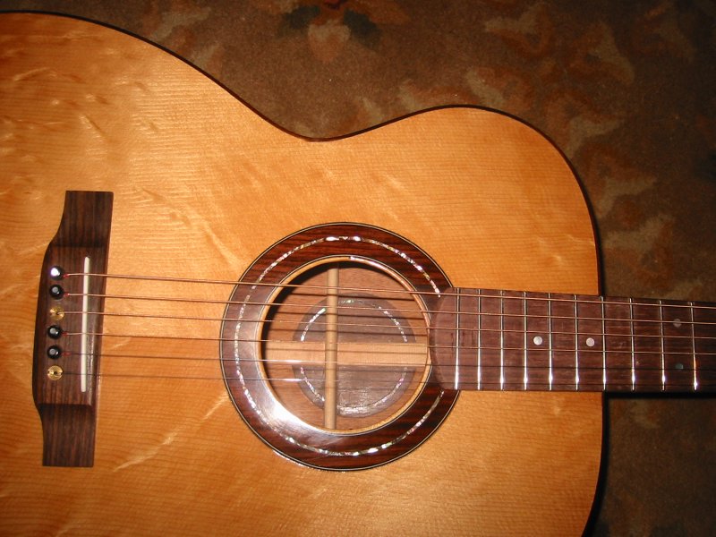

I got this brain fart when doing the back to use the cutout from the rosette and glue it up to the back so when you look through the soundhole you would see a shadow image of the rosette. Inlaid some abalam to match the rosette. Not real happy with the look in the end. Maybe because it didnt follow tradition.

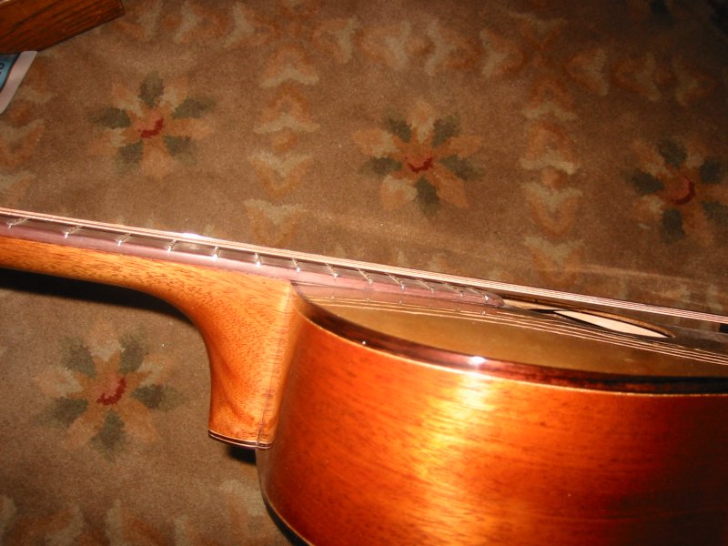

Now I need some advice. Some of you may recall my lengthy post on this guitar. The neck and fretboard did not fit and we all guessed in the end this was due to my sanding the neck block more agressivly than the rest of the top of the rim when sanding with a dish. I was able to compensate by thinning the fretboard at the soundboard area and combined with some work on the neck angle. As it turned out, it plays beautiful with a great action, great tone and good volume.
However (I hate that word), I ended up with a slight gap between the fretboard and soundboard at the very edge of the body. The freboard is not yet glued up and I dont want to force fit as it will impact the playability.
Any advice on how to cover up this defect is appreciated. Was thinking of making a rosewood wedge?

awesome exceptionally the top that is some bearclaw MichaelP38824.8429050926

Looks very nice.
Is that an EIR fretboard? I think you would have luck making a tapered "shim" type wedge that will slide into that gap. EIR is pretty forgiving that way. It will look a bit crazy as there will be a slight step when it meets the heal but I'd take that over a gap anyday. The other option might be to force the heal down so the gap goes away, then re-level the fingerboard (you'll have to remove frets for this). That will result in the fingerboard being thin at the end but again, I'd take that over a gap.

Wow, that bear claw pattern is exquisite! I also like the matching inlay on the inside of the back below the sound hole.
For what it's worth, I wouldn't have noticed the small gap under the fretboard from the photos if you hadn't mentioned it. Maybe you could highlight that as a design feature somehow? I'm not sure how you could make it "invisible." I'm curious as to what some of the other folks suggest.

Yes Rich I would make a wedge to fit the gap. Man,
thats a purdy bearclaw top.I like your rosette idea too.
Very Nice!

Yup a wedge is the way to go.

Amazing top!! Must have been a huge bear!!
Great job!! Keep 'em coming!

Thanks guys for the feedback. Guess the wedgie is the way to go.

Okay, now you got my attention buddy! very title for a thread, i just love it, i like it, i want some more of it!
That Bearclaw top is really beautiful Rich, i also find cool and unusual to stick that soundhole cutout in there, really original to say the least!
Your combo looks well balanced with Bearclaw and Mahogany, and rosewoods for fretboard and bridge, i love it!

Good save Rich....with the wedge your heading to home plate. Well done!

Just slap some Bondo in there. Ha ha, just kidding. A mahogany wedge might look nice though. I like the rosette "shadow" as well. Very cool idea.

Beautiful guitar. Love the top & the rosette!
I've never seen a guitar with those cool feet on it before... Great Idea! I always forget my guitar stand when i go to a jam... I'm gonna have to try that! Do they fold up to get it into the case?
